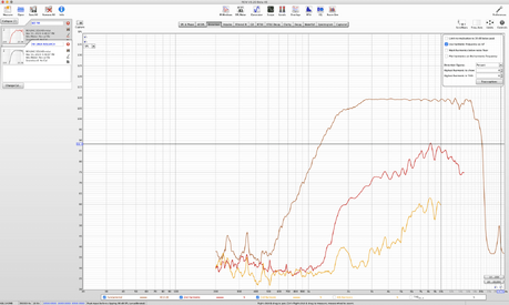

Dear REW Friends,
Very youseful option do not working.
I use REW everyday and measure compression driver's distortion at different levels. But this funktion is very very important to me :)
"Use harmonics frequency as refference" button in the DISTORTION menu.
I am working on Mac OS
Regards from Bulgaria
Ivan Tsanov
7,357
The option only has a visible effect when the distortion plot is normalised, since it is only when normalising that a reference is used. The plot is normalised when the Y axis selection is dBr or %.
