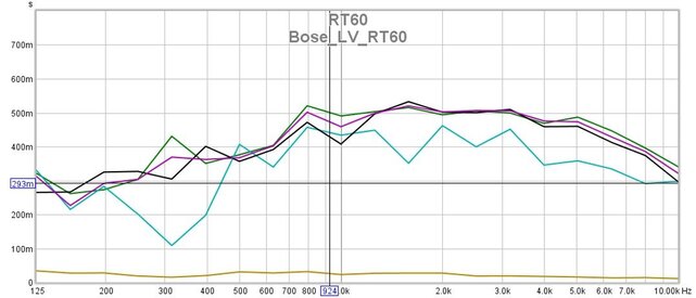

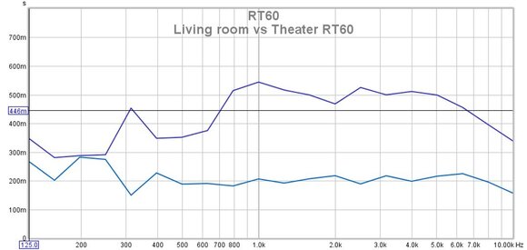

Here is the RT60 and Comparison:
RT60 Comparison. Theater is flat around 200ms, the Living room is not flat, ranging from 300ms at lower frequencies and midrange and 500ms at higher frequencies.

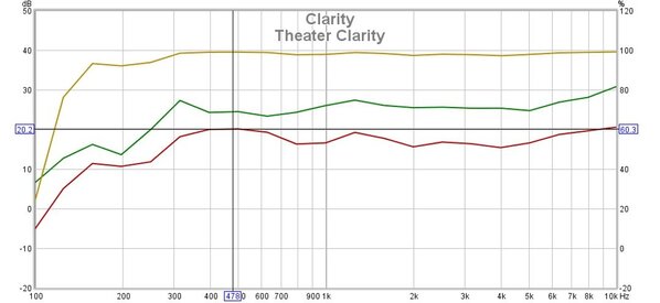

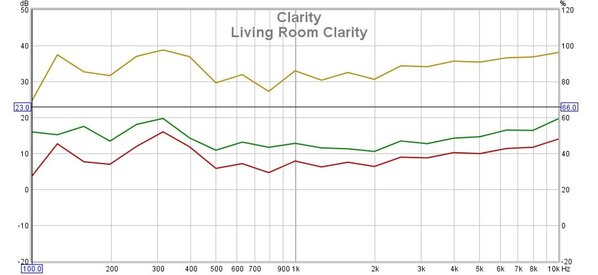

Measures of clarity aren't often used to assess a theater, but I think they have meaning. There are no standards for theater, basically higher the better, but what numbers sound good is unknown, and certainly at some point it could be too high. It is highly related to RT60, its a ratio of direct and later energy, so high Decay increases these values. I'd love to try and study this and find a way to correlate different clarity values with perceived clarity in the voices and music. None the less, here is a graph from each, you can see the theater is higher, as expected with the higher decay.
Living Room

You will see that the clarity values are clearly lower across the board for the livingroom, but its flatter to lower frequencies. That is because walls are great absorbers of bass, but not when they are thick and stiff, as in the theater. The CLD walls damp well, but it seems to only work at very low frequencies. In that 70hz to 150hz, its mostly reflective (but a normal wall would actually be somewhat absorptive).

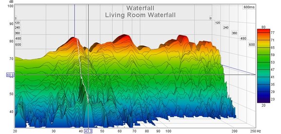

Living Room: As you can see it doesn't look too bad. The response isn't as flat nor as extended. There isn't really much ringing from any modes, just one at 43hz. I haven't bothered to measure the room to see if that aligns with a mode, and oddly, the same kind of mode shows up in the theater. Since the house has a lot of rooms with common dimensions, it is possible that they have a common dimension that causes this.

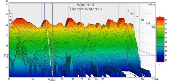

Here is the theater, no EQ or Dirac is being used in this waterfall. As you can see, there are two modes. One is at 43hz and one is at 22hz. I do know that in this case those do happen to align with room modes. The 22hz mode doesn't respond to eq all that well and is a length mode in the room.
Overall I saw what I expected (mostly) but it isn't what I was hoping for
. The living room has better LF decay for not having any treatments, and given its construction, that makes sense. The treated theater has better decay overall with much smoother and flatter decay. It's better overall and does highlight the benefit of planned treatment. Especially in RT60 and Clarity.
I was hoping to see big ugly ringing, but alas, that wasn't to be.
