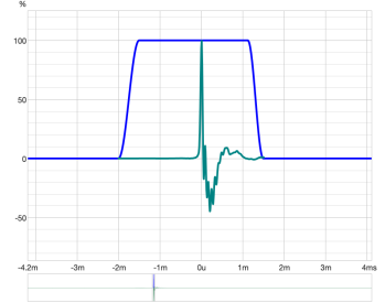

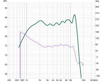

When I have measured SPL and phase for low and medium frequency drivers, I have studied the phase response and step response.
I have seen that if I have a positive step response I can adjust the time offset using "Actions" so that I have a range in the phase response that is reasonably flat around zero.
If I do the same with the sound card "invert", I get a negative step response and I can get similar range flat around 180 degrees.
This makes sense.
Now, I am testing an old Celestion HF1300 tweeter, and I am surprised of what I see.
The SPL response is not exactly flat, but ok for this vintage unit.
I set sound card "invert" so that I get a positive step response. It is due to my wiring,
Now, I can only get a flat phase region around 90 degrees, not zero.
If I set it to a negative step response, I can get a flat phase region around -90 degrees.
Can someone more experienced explain to me why this is?
Is this specific to tweeters only?
Or is the HF1300 special in this respect?
It has a quite massive phenolic diaphragm compared to moden domes.
