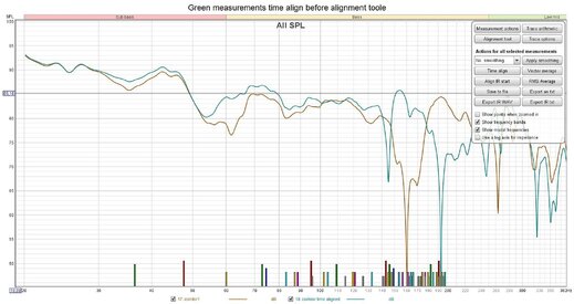

Here is two alignment sum of the same 2 measurements. The difference is that I hit "time align" button before doing the sum with the aligment tool. Which one is the best prediction of a second sub effect?
In fact there is my question: when using alignment tool do we need to time align the measurements befor even if all those were taken with an accoustic reference?

The original calculation is the correct one. It reflects the distance difference between the 2 SW.
REW 'time align' shifts the selected measurement impulses to t=0. The original timing relationship created using acoustic timing is lost. To implement that change in relative delay timing between your 2 SWs would require; the MiniDSP you mentioned, a new AVR with that capability, or some other device that can delay one of the SWs. The new SPL trace correctly shows the result of that particular timing change. Often, time aligning 2 SWs to t=0 is a favorable situation as shown here. It is the starting point for setting up multiple SWs, but sometimes a better result can be obtained with some timing offset.
The REW alignment tool provides an easier way to investigate the impact of any change to the relative timing so it is the more versatile tool for this type of job.
