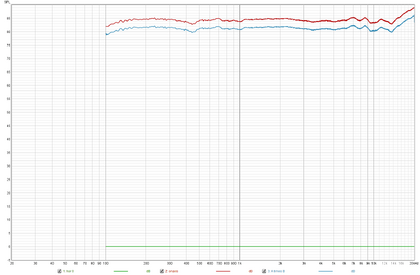

I have a set of normalized polar measurements (.mdat) that I'm trying to combine with an on-axis response, which is saved in a txt file.
The issue I'm having is when I multiply the normalized response (say, 0°, which is basically a flat line) and the on-axis response imported from a txt file, the result is 3dB too low.
Looks like it happens when only one of the measurements has an impulse response. If both are loaded from a txt file, or if both are from an mdat file, the problem does not occur.
