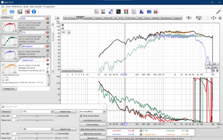

The measurements look good. I haven't used VituixCAD2 or XSIM so be sure to follow their measurement processing and entry instructions.
I can only confirm that with this mic location the MR needs 0.13 ms less delay (or the TW needs 0.13 ms more delay) for the 2 drivers to be aligned throughout the range of 2 - 9 kHz. The phase tracks very closely through that range. I assume 0.13 ms is the number they would require to identify the relative offset of the 2 drivers to put them is phase.

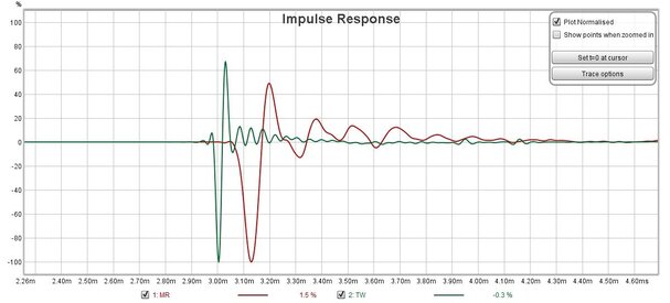

I also noticed that both drivers measured as being negative polarity. The 2i2 does not invert polarity so either they are both wired wrong or possibly you have inadvertently set the REW soundcard preferences to invert the soundcard input.

1. How did you determine polarity has been flipped? What graph shows this?
The impulse overlay chart I posted shows the initial rise of both impulses are in the negative direction. You can invert them in REW impulse controls instead of remeasuring them if you like. Inverted or not all the modeling will work out correctly in terms of XO modeling.
