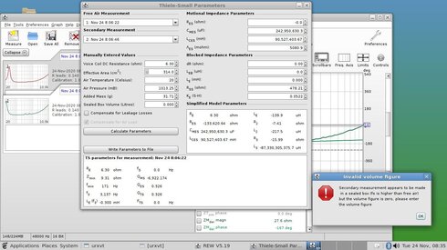

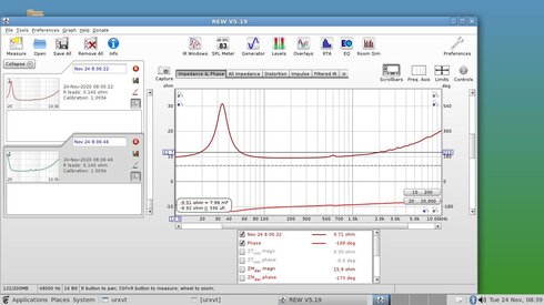

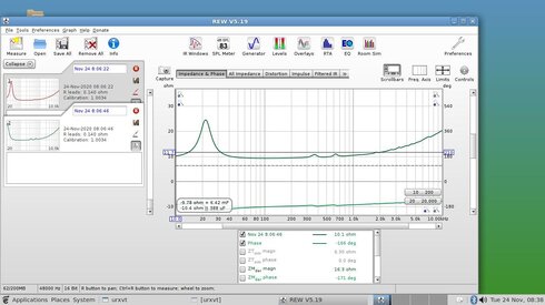

Hi,
First off, thanks for this software. Much appreciated.
I have an issue calculating the above characteristics. I'm using REW5.2 on a linux laptop, set up with a decent amplifier, 5Ohm sense resistor, ~1/100 padding on the card inputs.
First up, the free air measurement of a 10" woofer
Added mass measurement
The final error message, after clicking through the dialog box about reducing the resistor value (which always appears, no matter the input value).
Looks to me like it's not figuring out the Fs properly, but I'd love to be able to fix this.
TIA, Rex

Phase is about 180 degrees off at resonance, the input channels are probably the wrong way around. The screen shots show 5.19, should probably try the measurements in the latest V5.20 build (which would have shown a message about that phase disparity).
RexJohnston
Nov 23, 2020
Fantastic! Sorry about the incorrect version. I should have checked. All good now.
Cheers, Rex
