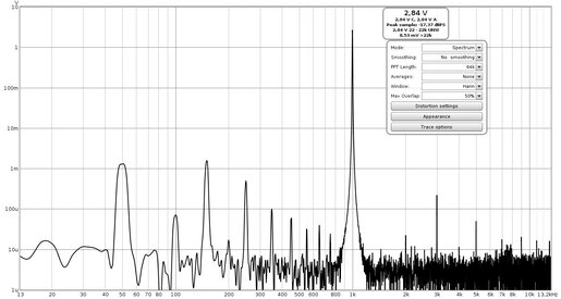

John, I apologize for being superficial in describing the problem, but at the time I couldn't describe the details.
Now I'm working with a sound card that samples at 192Khz and with an input and output buffer of 32Kb, REW generates a frequency of 1Khz and simultaneously performs the RTA function with the parameters that I send you in the attachment. Even when I resize the RTA window it almost always takes a long time to update the graphics even when the recording is turned off. Attached I also send you a video of how the RTA function behaves so you can evaluate the update time of the graph.

I noticed that between the setting of the RTA function there is the Max Overlap parameter. As you increase the value, updating the graph speeds up and the workload on the CPU of the java process increases considerably. It goes from 10% CPU load with the setting at 50 to 30-40% with the value set at 93.75.
What does this Max Overlap parameter do?
Thanks John ...
7,337
From the help:
Max Overlap
The spectrum/RTA plot can be updated for every block of audio data that is captured from the input, overlapping sequences of the chosen FFT length. This can present a significant processor load for large FFT lengths. The processor loading can be reduced by limiting the overlap allowed using this control.
To expand on that, each FFT requires the number of samples in the FFT length. If max overlap is zero. REW will wait after generating an FFT until another FFT length set of samples has been received, then run the FFT again. If the overlap is 50% it will run the FFT after half of FFT length samples have been received, using the last half of the samples from the previous FFT plus the new samples. The more overlap is increased, the fewer new samples are required to trigger a new FFT so the more often FFTs happen.
There is also an Update interval setting in the Appearance controls, if that is increased from 1 the graph will only be updated at the chosen interval though FFTs will still be calculated per the chosen overlap.
