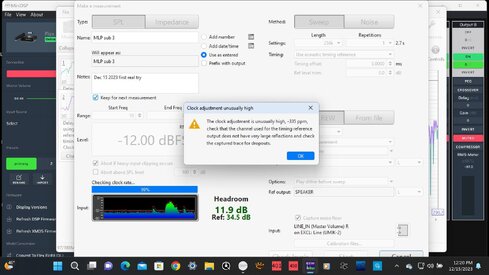

"The clock adjustment is unusually high"
cvanc
May 29, 2020
13
Hi, is there anything in the attached files that can clarify what I'm doing wrong? I can not escape this error message no matter what I try. Thanks.
  • REW clock adjustment error.mdat

Everything looks OK. The clock adjustments are a bit variable, and per the message the adjustment for that last measurement is unusually high, but the measurement still looks good.

"exact same" meaning mic on a stand and no movement of mic or anything else in the room between measurements? There are substantial differences between the measurements, if the mic was in the same place for each they should be very similar.

Measurements look OK assuming they are from different positions. I'm a little puzzled by the variation in clock adjustment, particularly since measurements 1, 4 and 5 are identical at -91.7 ppm but the others range from -51 ppm to -173 ppm.
Since you are measuring subs you could set the sweep end frequency to 300 Hz, everything above that is in the noise anyway.

Still getting variation. Attached file is just me grabbing samples quickly with no changes at all. Took all of 90 seconds? Errors popped up with quite different values to complain about.
I've wiped & re-installed REW and turned HW acceleration off, I read that might help. No change.
You think I'm OK to grab fresh mic samples with things as they are? And again many, many thanks.

Those responses are all the same bar the noise floor, so that looks good. Not sure what is causing the timing variations, how is the SHD connected to the main speakers?

I got it fixed.
All this gear is lashed up with a slightly ugly USB network. I went thru the whole thing with D5 & a swab and immediately was able to take the 24 samples I actually need with a consistent error of only ten. So... flaky USB seems to have been the culprit. I'm good to go. Thanks for checking in.
