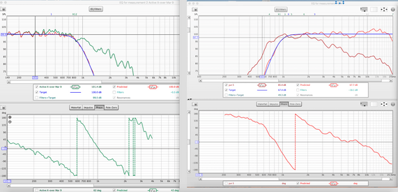

This illustrates the challenge - for example attempting to phase match two 48db/oct LR responses crossing at 900hz. There is a decent match to the LR8 frequency response, but the predicted phase is off, theoretically phase should track each other in the crossover region. It is unclear if both or one of them is off. If one could compare predicted phase to target phase or and/or predicted phase of other driver while modelling it would help.

Difficult to say for sure from those images, but neither phase response looks correct in as much as both look like they may have a component due to time delay, i.e. the t=0 points for the responses are not correct. The group delay plots might show that. Phase is so strongly affected by measurement time delays that it is often difficult to make any meaningful use of it. The Predicted Phase overlay graph lets you more easily compare phase plots, provided the measurements have valid (or at least comparable, sharing a common timing reference) t=0 positions.
Your one chart indicates an active XO. If that XO has delay options, i.e., a DSP XO then the phase can be adjusted as needed by adding delay as needed to one of the drivers. If the XO is analog then the adjustment is by either changing the relative driver offset, or adding an all-pass circuit. Either way given REW measurements the REW alignment tool will find the correct adjustment needed for delay or offset. The measurements can or should be in the same mdat file. This post and its thread may be helpful. The requirement requirements for the measurements is also indicated there. I can help out as needed.

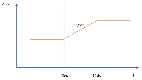

Indeed it is active crossover, but not DSP. I shall check the thread you refer to, cheers. In my example the timing offsets are removed, but I have found the phase difference is due to a high shelf added in REW EQ as compression driver compensation. This shelf needs both an upper and lower knee (say 2khz,10khz) , but in REW I can only control the upper knee, so the shelf in effect acts as a delay in the crossover region.
If you wanted a shelf with a shallower slope the LSQ/HSQ filters allow a lower Q to be used.
I tried, but cannot seem to be able to model compression driver (CD) correction in REW. In this case CD correction is by tweaking the HF power amp frequency response, creating something akin to the model showed in the plot.
Great equivalent, cheers!
