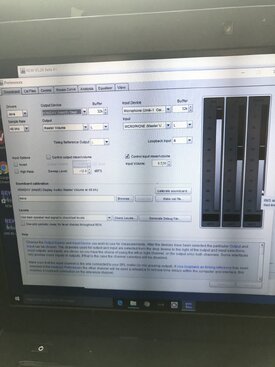

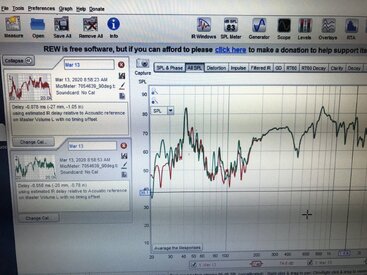

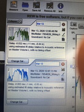

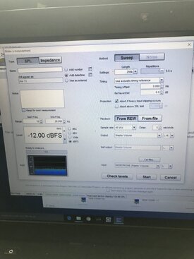

Hi Guys, i really need some help here , i'm trying to do T/A with REW i keep failing..... setip: umik1 usb mic .... laptop with HDMI to A/V converter to HU as output and USB mic as input.... soundcard does have an aux mic input and an aux headset output. I cant figure out how to make that loopback i need to do T/A can you please help me out with how to configure REW settings. Banging head against the wall. Any help much appreciated
