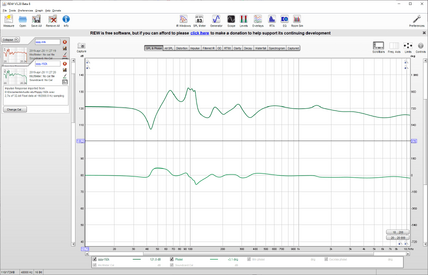

I found the problem, its the higher sample rates that gets wrong. I did a correction from a measurement, exported if (Export filter impulse to wav) to both 44khz and 192khz. Then I imported them and looked at them
44Khz (sound correct):
192khz (sounds muffled):

Do you have a notch filter just below 20 kHz? Filters close to the sample rate limit will have altered shapes, so the 44 kHz sampled version of a filter that high in frequency will be misshapen and the 192 kHz closer to the shape of the analog equivalent filter. In any case, a deep notch up there is unlikely to be a good thing.
Don't remember and now its gone, but did a similar correction and got a similar result (but not quite as bad). Only auto-correct from REW, and REW put a -9.6dB filter at 19897, see below for a screenshot. So its probably what you said, but with regular filters instead of notch.
As you can see, my measurement shows an increase at a very high frequency, which is what REW tries to correct.
I tried a -10dB HS filter instead at 19khz, but then the 192khz became about +6dB higher all over the frequency (the shape was also a little different but not so bad).
Btw, if I want my correction to look exactly like in the EQ window, which frequency should I output to?
The Generic EQ setting is at 48k. I strongly recommend you do not apply any automatic EQ above about 200 Hz. The higher the frequency the less likely the results will be beneficial. If you want to apply filters for tone control better applying them manually and keeping the corrections small and broad.
Cheers, I usually don't do automatic correction, I like to do it manually and trying to use as few filters as possible, and as you say keep the Q down. Just never noticed this behavior before.
I think I will only generate 48khz impulse response and then use that for all sample rates (I use Roon, and it down/upsamples the filter if needed). Seems that is better than risking filters deviating from the view in the window.
