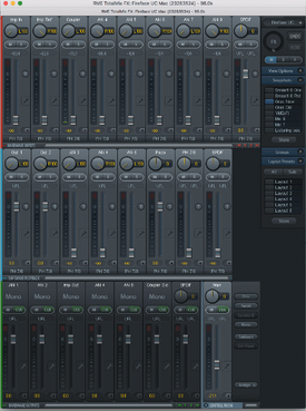

In the RME total mix software I have also some snapshots in order to recall different setting(Input, gain, Etc).
55788

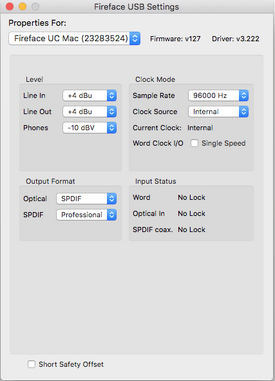

Together with REW I do use Smaart v8, both set to 96Khz.
When Smaart is open alone, everything is working correctly, all the inputs and outputs are calibrated as stored in the snapshots. Once I open REW and select a Fireface interface as Input, the stored snapshot is messed up and the button indicated by the arrow start flashing ( means that the settings are no more the same), and I find myself with 8.5dB more gain on the inputs, both in REW and Smaart 8( the strange thing is that the gain values on the snapshot do not change, but using a calibrator I have verified that it increases by 8.5dB in practice). At this point I have to disconnect and riconnect several time the USB cable in order to "re-sync" the audio interfaces and reset the inputs to the gain stored in the snapshot. Recalling the snapshot doesn't sort any effect, it is like the audio interfaces lost the sync when REW start.
