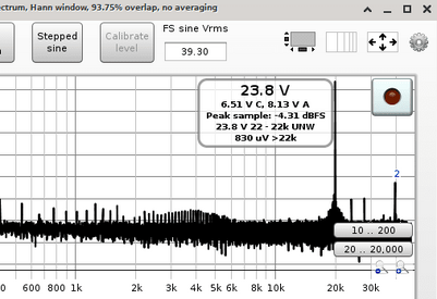

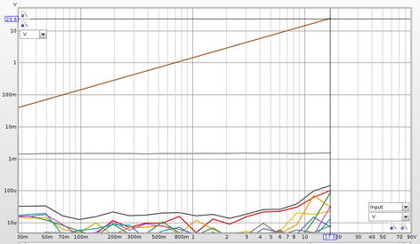

You can see that the X and Y axis are set to input voltage but the X axis shows 17V which is close to 0.7071x the Y axis value. The RTA reports the correct input voltage which is 23.8V.

Thanks for the report. I have fixed that for the next build, along with the missing line at the bottom of the RTA graph and the incorrect legend values for stepped level measurements when the axis was not Generator dBFS.
