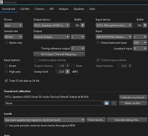

Wondering if the culprit could be that untickable 'control input volume'...
The input volume shouldn't be active in WASAPI Exclusive mode, but you can adjust it via the Windows audio properties for the input.
Thanks John, It's at 100% by default.
