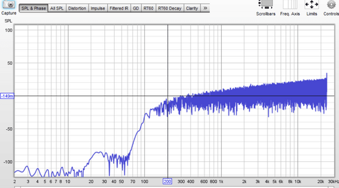

For a reason that i can't find, the curve of my Focusrite starts to go down at 40hz

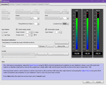

On REW preferences :
OUTPUT speakers = L
INPUT = L/1
loopback output = R
loopback input = R
AND IN REALITY i succeeded to get this anormal curve with patching the "loopback" input on R but i just realise that i cannot work by this way because the loop shouldn't get an IN.
The think is that when i tried to measure the soundcard with the logic patch ( Time reference output : R / Loopback Input : L just like on my card ) the measure was clipping and i was getting a clipped curve.
Maybe should i try to fix the things on this way before to see about the anormal curve... that would probably disappear
does anyone have an idea about the source of my problem?? Maybe you already perceived it in my reasoning?
