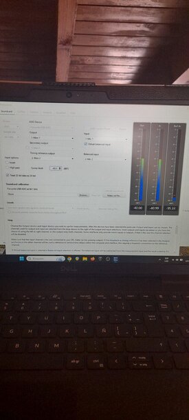

In this case the reference enters by in (in this case it is the same).

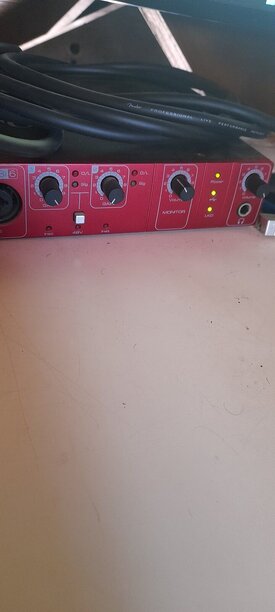

As you can see in the photos, the sweep level is at -40, and the input gain is at maximum, and in this case helped a little by the monitor volume.
Although I could lower the input volume and help with the monitor volume, my idea is to use the volume less in general.

The system seems to have strange gain staging, with significant attenuation from the output level control which you are having to offset with heavy gain on the input stage. Seems an odd choice.
Is not a choise jej.
All the systems had the same problem, none of them had a low level output and still sounds low.
