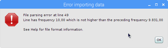

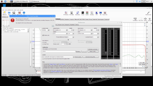

I performed the calibration on the system composed of a Raspberry pi 3B processor and with sb1240 USB audio card and at the time
of saving the rew calibration file it displays the error that I attach in the figure.
The calibration file is regularly saved, but it cannot be used to carry out the frequency response response and in phase because
the same error is found.
I enclose the screenshot of the error, the calibration file and the log files that do not present errors.

Thanks Antonio, I have fixed that for the next build. In the meantime the file will load OK if you remove the comment lines, the parser is mistakenly thinking comma is the decimal delimiter for the data based on content it is seeing in the comments, which it should ignore.
