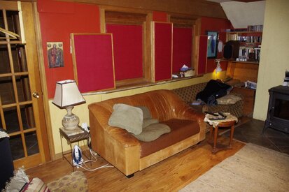

Please take a look at the photo. The MLP is on the leather couch, left side of the couch . MLP is 8 feet from the front speakersThe back wall seperate the room and the shop in my basement. You see 3 DIY panels on the back wall. Between them, there are 2 square frames (31inch H x 24 inches large) where it was 2 windows. On the shop side of those frames I've put 8 inches Rockwool AFB.
I can't get rid of the back wall to get a deeper room. But, I could do on the upper part of the wall one large "window" of approx 7 feet large x 3 feet high behind the MLP to replace the 3 panels and the 2 windows and fill it with mineral whool in the shop side of the wall.
Am I wrong to think that it will change the main room modes (room dimensions, tangential and diagonals ) at the MLP and help to smoothen the response to lower the highs and lows differences between 20Hz and 500ish Hz.

Is the "front" wall where the speakers are treated? The corners? I'm not against treating the back wall, I just am not sure it will make as big a difference given that there is already some treatment there. LF treatment works best when placed on the offending walls causing the specific reflections you are trying to address. They can only do so much, of course. I like to treat the walls closest to the speakers with bass traps to solve things like floor bounce/ceiling bounce cancelation, SBIR effects, etc. Room modes are trickier, I just prefer multiple subs, but certainly nothing wrong with having some LF damping as well.
As for your window idea, I wouldn't bother. It's much better to keep a room as close to a classic cuboid as possible as it makes the response predictable and treatable. Making changes like you describe would have unpredictable results. A hole in a wall is also resonant, so its possible it could cause a new problem.

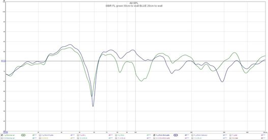

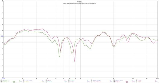

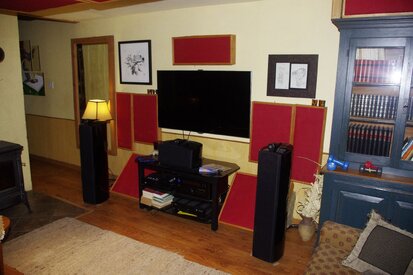

The front wall is treated (see photo but note that I get rid of the 2 DIY traps on the floor because it gives poor results for the trouble mean WAF.) More sub is not an option for lack of space. 2 tri-corners are treated. Now about SBIR see photos here. B&W recommandation is to put out at least 50cm from the back wall. You see the result if I move the speakers closer at 20 cm from the wall. To my ears (is my brain tricks me ?) it shrinks the SS&I.
I give mdat for one measurement .

This all looks good. These measurements are much more in line with what I expect to see with non-averaged measurements and because they reveal more of what is going on, more helpful (to me) in treating a space.
To treat SBIR effects caused by the front wall behind the speakers, you actually need traps designed to be effective at those frequencies. A dip at 55hz is so low that normal velocity absorption won't do much. You would need to have like a foot of insulation on the wall and covering most of the wall. Might not be worth trying to treat anymore.
I believe that you should always place main speakers where the SS&I is best, not where the bass response is best. Fix the bass using other means such as subs, acoustic treatment, and EQ. If moving them closer to the wall makes things worse, don't do that. Sometimes moving the speakers farther forward into the room can lower the dip frequency to the point that it appears to disappear, and....make SS&I even better. In big rooms, I much prefer this approach.
Now as for membrane traps, the trap does not need to be sealed. That is a panel trap you are thinking of. The mass of the membrane acts on it's own, it doesn't need "contained" air to increase the spring, it doesn't work that way in this case. In this case, the mass is the membrane and acoustic fiber material combined and the spring is the fiber compliance. In the design I'm talking about, the membrane is adhered to the fiber directly. With a low density membrane like I'm talking about, the operate over a wider bandwidth. They don't have the same peak in LF absorption that a panel trap or limp mass membrane would have, but provide a useful improvement over other designs.
