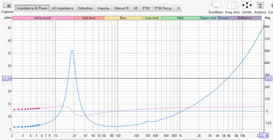

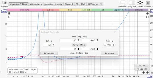

Click on the icon << Limits >> to the right of << Freq.axis >>, then click on << Fit Y to data >>.
Doesn't work. When measuring Impedance it goes max. 1000 Ohm on the Y axis. Also entering it manually doesn't work. It jumps back to '1000.'
