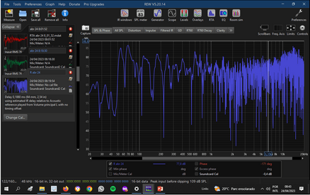

when I make sweep measurements the levels are correct see the print!
Sacenti
Jul 2, 2017
59
When I make measurements on the RTA the levels are displaced see the print!

59
John all right now! measurements are the same sweep vs RTA!
On Friday came a java update and when I opened the REW I lost all the REW settings. It's the first time this happens with java, believe me!
Thank you very much for the prompt service John! You are a very efficient and dedicated professional! Congratulations!
7,340
You're the second person to report that, seems that Java update was broken in some way.
