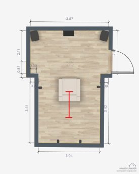

Room layout (plan)

I’m in the planning phase of a home theatre room in my basement, with the space that I have I’m coming up with a few ideas the following is one of them;
Would this be OK for acoustics?
Please provide any feedback would be appreciated.

The dead center of any square or rectangular room is going to be a "bass hole," so to speak. I.e., the perceived bass level is lowest there, and increases as you move from that point towards any boundary. Not necessarily a problem, except that it'll require more subwoofer output than would be needed for a seat near a boundary.

Where will the screen or display be located and what size?
Are those the mains in the diagram or sub(s)?
How high is the ceiling?
If you leave the speakers in the corners, you"ll have extra bass. If they have port at the back, the speakers should be moved 60-70 cm away from the front wall. It is better to change the listening location to something between the center and 3/4 of the front wall. The reason was indicated by Wayne A. Pflughaupt.
So the exact placement of the audio components isn’t exact, I could move the audio components around to maintain better sound quality.
I do, however, have two subs that were not included because I’m not sure where to place them yet (thanks for your reply Wayne A. Pflughaupt).
The ceiling is going to be 6 feet high, I am gonna go with a 7.2 set up, the length of the room is negotiable, but the width is not (since the screen width is almost 11 feet, the width of each main is about a foot I would require a minimum 13 feet width on the larger width portion of the room, unfortunately, I cannot maintain a symmetrical rectangle or square which explains why the incline on each side, which is about a foot (per side). There will be a couple of columns within the room, but I’ll make sure they’re not in the way of viewing.
So are you suggesting (changing my listening location) as in my seating?
Between center and 3/4 of the front wall?
I can alter (lessen) the length of the room which I have diagramed at 18 feet, but the width (13feet upper portion and 11feet lower portion) cannot be altered.
I can always move the speakers away from the front wall as indicated by yourself thank you for that!

I have (2) FOCAL SUB 1000F (110V) not included in the photo, to your point about bass level and any suggestions as to where I should place the subs? I am going to run a 7.2 set up.

Sorry, I didn’t initially mention where the screen would be, the screen is between those two mains in the front. They are not subs.
Ceiling height, unfortunately is 6 feet
Would it be a good idea to put my centre channel above the screen just touching the ceiling? Or should I leave it where it is? Illustrated in the second photo?
Now your chair is in the center. The interval where it is worth trying other places is indicated by the red line.

Do you have the screen already? I ask because at your screen width and a choice of room length, an acoustically transparent screen with the speakers behind seems like it would work better. Especially for the center. If not then center below and angled to ear height at the seating position. We don’t know the aspect ratio of the screen, so I’m guessing based on the width you’ll have only a little more than a foot below it, so keep in mind with the center tilted it’s effective height will be greater than it’s actual height measurement.
As has been mentioned the seat position isn’t the best for bass, but horizontal viewing angle is also important. While it’s somewhat a matter of preference, 45° is the THX standard and I believe @Matthew J Poes (Poes Acoustics) would recommend 60°ish (a range of 45 to 70° if memory serves. Maybe others here will chime in with their preference. So that said, here’s a good tool you can use to arrive at a seating distance based on screen size and viewing angle.
Anyway, I think you’ll find at 60° the seat will move closer to the screen from the current position. And I think it will get you closer to an equilateral triangle with the seating position and mains. Let the math begin :bigsmile:

The screen is already purchased. It is not acoustically transparent., it is a 2.35:1, 140 inch diagonal
The seating location in the diagram isn’t actual, it was only put there as a reference to be included in the room layout most likely I will push the chair back a little.
Was wondering if I went with a perfectly symmetrical (without inclines as diagramed above) 13 ‘ X 16’ room instead of the above mentioned layout plan.
Would that serve as a more acoustically richer environment?
A perfectly symmetrical rectangle 13' x 16' would likely be better than the shape you show in your above diagram... However, your ceiling hight of 6' is not optimal...
