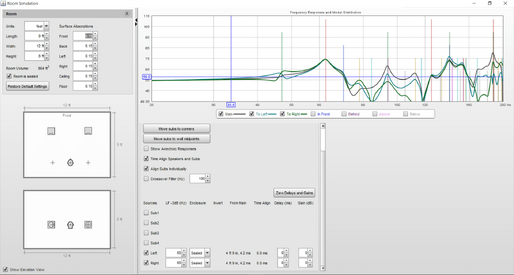

Hello guys,
I followed a nice tutorial (in french) to calibrate and measure my future studio.
What I used for the measures :
- Yamaha HS 50 M
- MOTU Audio Express (calibrated)
- Sonarworks measurement microphone
All signal levels were calibrated and ajusted (SPL meter with sonometer).
The room is about 12m2 (39feet). Two parallel walls are made of plasterboard, one in the back in stone (with window built in), and the front one will be the accoustic door.
Ceiling is plasterboard and floor is parquet.
Attached are my REW measures.
So, the things I see :
All SPL
- Problems in the lows (speakers are cut under 50Hz) from 50Hz to 122Hz ; then pit at 211Hz
- Some pits in the mediums : 650Hz ; 740Hz ; 1300Hz ; 2148Hz ; 2563Hz ;
- Some pits in the highs : 3460Hz ; 4210Hz ; 4940Hz ; 7740Hz ; 14790Hz
Impulse
- 500ms to fall
RT60
- 1.3s at 60Hz
- Then it gradually lower to 250Hz (537ms) until highs (400ms at 8KHz)
Waterfall
- Says pretty much the same thing
Spectrogram
- Huge pic at 137 Hz (607ms), and same as above
So here are my questions :
Im I right reading those graphics ?
What should I do to correct those problems ?
Things I consider :
- Bass traps to catch those bass pics/reverbs
- Accoustic pannels on the walls for general reverb and adjusting the frequencies
- As well as diffusion pannels to smooth the frequencies
- A carpet under my desk/chair/etc
- One accoustic pannel on the ceiling ?
If I'm right, how should I place them ?
Thank you for your time
