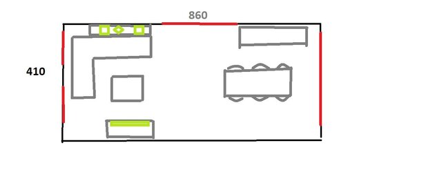

I added the mdat and a very sophisticated drawing of my living room. Windows are red, furniture gray, speakers green.
On the left side you see that my 2way speakers (dayton rs 150 and dc28) are standing on ear-level behind the couch. Inside the 'knee-wall' they are standing on, there's a wall-facing subwoofer box (pretty cheap car subwoofer).
I also made a soundbar (dayton nd90, nd25 double MTM) that's on the bottom left of the floorplan.
I'm looking to identify the speaker-related weak spots and I think I have a lot of room-related problems too. I have a lot of hard surfaces (windows on 3 sides) and the furniture. I do have a carpet beneath the coffee table. We are thinking about hanging curtains on the left and right windows.
My other half is not keen on 'visual' sound enhancements (foam or carpets on the wall) so that doesn't help..I do think we could add some foam behind a painting if that helps?

You should ditch the soundcard cal file, it isn't a valid result. You can use the Change Cal button to remove it from existing measurements and clear it from the Soundcard Preferences to ensure it isn't used for new measurements. Don't worry about making another one.
To measure the speakers rather than the room you would need to measure them at a distance of 1m from the mic and as far away from other surfaces as they can be moved - at height outside is good - and window the impulse response to exclude reflections.
Measure one speaker at a time rather than pairs together. Worth trying the sub with polarity inverted to see if it blends better with the soundbar that way. Your 2-way and soundbar look like they may have opposite polarity to each other.
Does look like the room is a bit lively, curtains would probably help.
