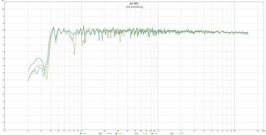

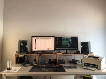

Hi everybody

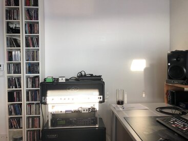

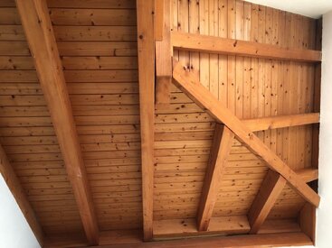

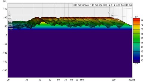

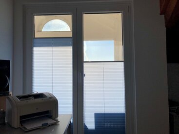

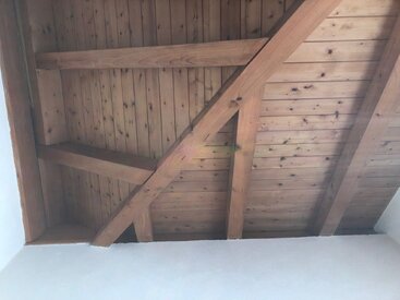

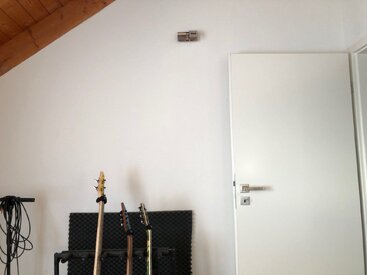

i measured my room and now i need help what to do.
On the pictures you see the room now.
I use the room to mix my music.
Thanks for help.

Need just a little more information on the three plots in the MDAT file. Are they left, right and combined? Are you measuring right at the listening position at your chair? But still, you're very fortunate the room does not seem to have very large peaks and cancellations, other than the narrow 80Hz null and the very predictable bounce around 40Hz. But the resonances take the decay out pretty long and you probably hear boominess in the mid-bass. If I'm interpreting correctly, some corner bass traps and absorption at first reflection will help. painkiller.jpg
Hi Painkiller, are those speakers the KH80 or the KH120? I'd love to know. Thanks, purely out of interest, so I can correlate your measurement with the type of monitors you use.
The response is very flat. I guess it's in the near field.
Another possibility is that the microphone input is saturating and comes out that flat (I know it from experience ), I say this because of the very high distortion of the 3 readings.
After taking the reading, look in the "captured" tab to see if there is a clip in the AD converter. and look at the clip light in the analog part of the microphone.
