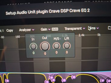

I use moving mic measurememt with success and end up with filters for fullrange not only below 200hz. I only cut frequencies and never boost. Compared to the rew suggested level for eq i decrease a couple of db to engage more peaks and my house curve Is set +1.8 on lows to have about +6db at 40hz and +1.5 decrease on highs starting at 3khz to have no sibilances. Overall It sound very good to me but... Today i bought a 32bit dxd record and on various tracks of It i have clipping on midbass ,when musical peaks arise. It happens sporadically on few tracks.
I have imported one of those tracks in reaper and it sounds very hot , with the highest peaks at -0.4db which Is unusual for my experience. I have another 32bit dxd and It Is recorded with peaks at -5db. Not necessary to Say It sounds perfect.
Is my issue coming from my eq attitude or Just the record too hot? What advises? All other files i play at 24bit ,they sound perfect.
