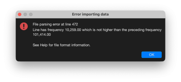

Dear Rew Team,
Since all beta 12x until now, some CAL files have had some issues. Here is the error. But the file is correct and the error is reading issue only in txt mode.
I included the original calibration file from the manufacturer.
Could you please take a look ?
Thanks a lot.
Fred.
Thanks, I have fixed that for the next build. In the meantime if you replace "," by ", " in the file it will load OK.
