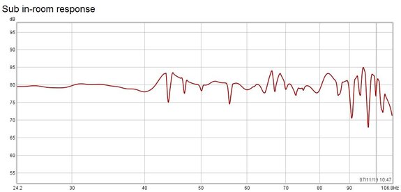

I've recently had to replace the amplifier in a B&W ASW750 sub, due to unreliability.
I asked B&W for the TS parameters of the driver in my ASW750 sub, as I was changing their amplifier for a Hypex FA501. I'm still awaiting their reply . I ended up running REW and inputting my interpretation of the results into the Hypex DSP with their software.
I've achieved a reasonable result by trial and error, but it would have been so much easier if REW talked to the DSP in the Hypex amplifier.
