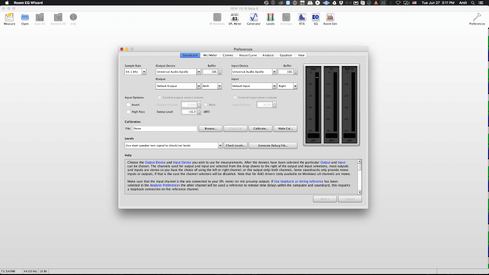

hey thanks for quick respone -
here is my setting -
and when i clock on test its not showing any input

Are "Default Output" and "Default Input" the only choices offered for input and output? If there are other options in there it is usually better to select them. There is a 'generate debug file' option on that screen, if you attach that file there may be other helpful info in it. May also be handy to see the options offered for the Apollo in the Mac's Audio Midi Preferences app, sometimes there are further input selection controls in there.

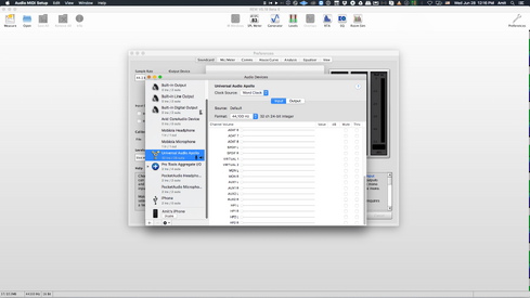

the input and output just have default and stream 1, and both not work.
in the midi in my mac everything look fine, i try every single option in the presences of rew and nothing showing input.

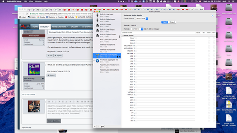

What are the first 2 inputs in the Apollo list in Audio Midi preferences? Wonder if they are the ones being fed to Java/REW?

The Null 1 and Null 2 at the start of the input list are pretty suspicious, that makes me think there should be a way to configure the Apollo to have two of the input channels appear there. From a bit of googling I suspect the Console -> Settings -> CoreAudio might be the place to configure what those inputs are.
