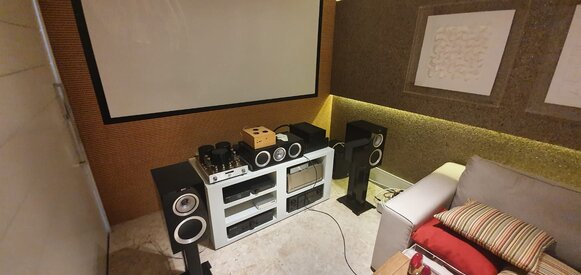

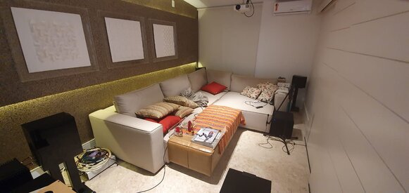

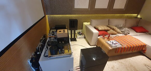

Hi @jtalden

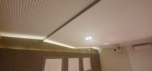

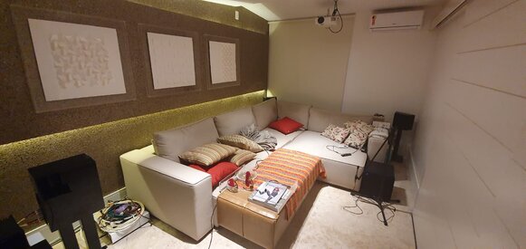

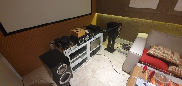

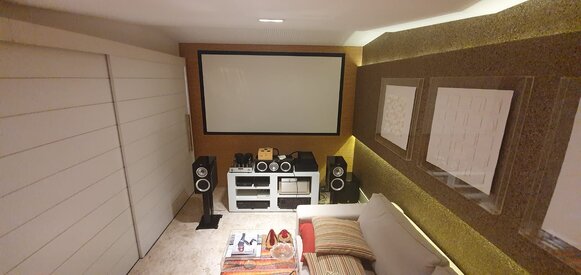

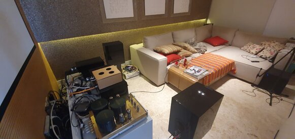

Here are photos of my room just for reference. All Walls are concrete with Dry wall on Ceiling and dry wall panel on right wall and Large Wood door on left side. In the last renovation of my apartment I did some acoustic treatments without much discretion. I put a perforated acoustic panel on the front wall (about 15cm from the front with glass wool inside). On the ceiling I put this "a kind of enlarged sew saw" (four panes) ceiling with wool fiber inside. There's this huge sofa that my wife gave me as a gift, which I can't move (waf).

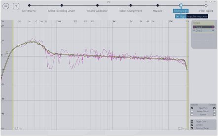

Hi @jtalden

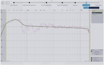

Here are the Dirac photos. I am new to Dirac, so I sent screen photos and also Rew final measurament including Dirac.
Dirac don't change minidsp plugin setings, so all delays and Sub peq we talked before remains.
If you want some more info please ask.
