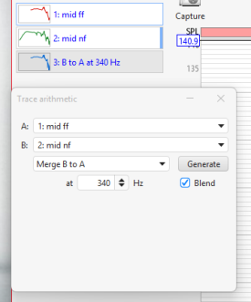

I am using REW 5.40 beta and I believe there is a bug with Trace Arithmetic → Merge when merging near-field and far-field measurements.
Here is the exact issue:

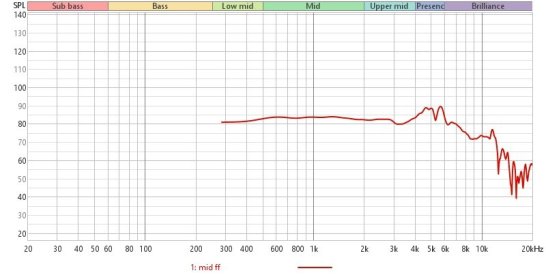

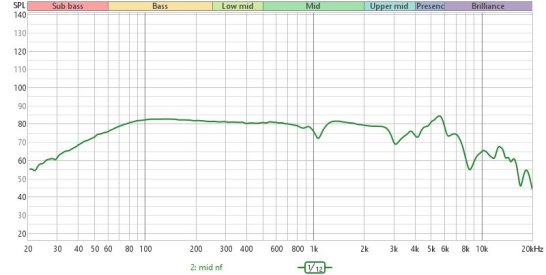

  • I have two measurements:
    • A = far-field (FF)
    • B = near-field (NF)
  • I first do Align SPL successfully (the curves match correctly in the overlap region).
  • Then I use Trace Arithmetic → Merge B to A at a frequency within the overlap.

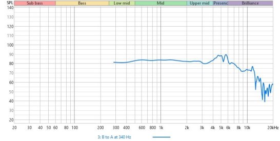

Result:
The generated trace is identical to the far-field measurement (A).

Seems fine to me. Note that you do not need to align SPL, merge does that automatically at the merge frequency.

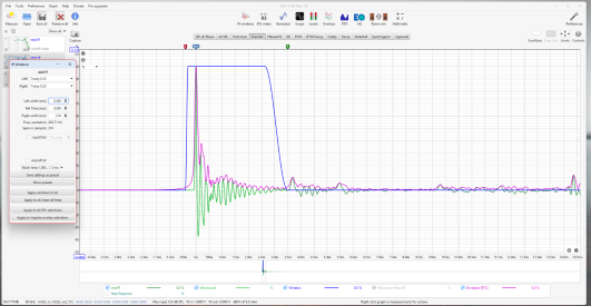

I found the cause: merge works only if FF has no IR windows applied.
If IR windows are applied to FF before merging, Merge B to A keeps only FF.
In REW 5.31.3 this worked correctly.
So it seems IR-windowed FF breaks merge in 5.40.116 beta.

It is still working, the bug is that it is defaulting to the measurement A windows for the result when it should be using measurement B. I have fixed that for the next build, but you can simply change the windows on the result.
