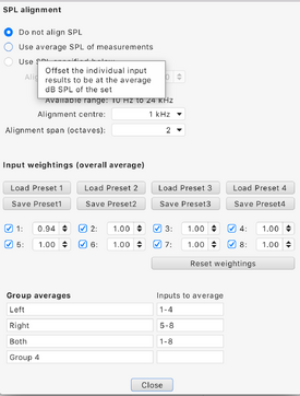

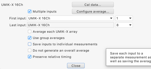

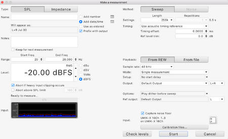

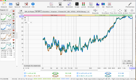

I was able to get this all set up and working with the latest release version that is as far as I can update as my Mac can not update the operating system to run the new beta. The issue I have is the mic and the labeling of the 1-4 inputs as say Left and the 5-8 inputs as right and it works as expected when using the RTA tab. The issue is when I go to the measure tab and run a sweep all the labels come out L+R even though the results are different so you can't tell what mic saw what. Please see images attached. Anyone know a way to get this to show up correctly on the sweep results ?

Those L+R labels are for the output, they appear when this option is selected:
The first of those 4 measurements is the overall average of all inputs, if you don't want that select this option:
