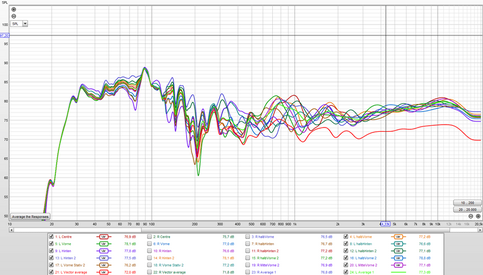

I have taken 10 measurements for each loudspeaker around my listening position, using a 20sec 10-20Khz sweep with default windowing (no FDW)
I have done an RMS and an Vector average and wonder about the difference. I am sure it has to do with the phase and am looking for a simple explanation and how to move forward.
I show all the measurements for the left channel below, the RMS average is in lime, the vector average is in red, some lower.
37369
I am showing the averages again to be seen more clearly. I added the centre LP in black
37368
Moving forward into EQ, I assume that I use the RMS average, but then I have no phase information, is that right? To move into RePhase, I would use the vector average. This seems kind of Ok if I stay blow 200 Hz (avoiding the large room mode) as all curves are the same there. However, I might want to do an EQ up to 13Khz as I am relatively close to the speakers and they are hence a bit too bright (and I might try to do some other stuff with HF EQ later).
I want to try that in REW first and then later in RePhase. As the averages above 1Khz differ almost by 10 dB, the EQ results will be different. So, which is the correct one to use? Or does the difference show, that I do have problems with the phase, and I should rather not attempt Eqing above 200 Hz?
On another line of though, I noticed that the centre measurements fit the RMS average quite well (after removing the two extreme measurements that are behinm my LP close to a tilted roof) and of course still contains phase information. Should I rather skip averaging and simply use that centre LP measurement?
I am thankful for any comments.

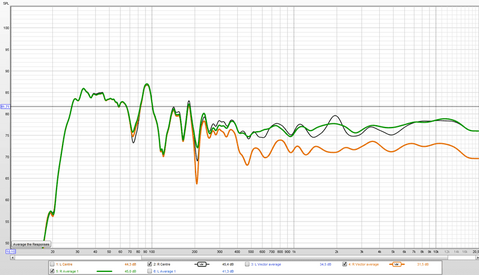

FYI:
For manual IIR PEQ I prefer using a RMS average rather than the vector average and address the entire curve. My process uses the moving microphone measurement (MMM) technique for EQ purposes. It provides the same response as the RMS average of many individual measurements in the same area, but is much quicker and is more repeatable. There is a bit of a learning curve however to do it correctly. I EQ the bass to about 250 Hz and also address a wide 450 Hz sag in SPL response. Above 600 Hz I only shape the rolloff to my preferred house curve.
I see that it is more popular to use the vector average for PEQ in the guidelines provided in the rePhase thread at diyAudio.
I use the LP sweep measurement to create the phase correction FIR. I just use enough FDW (maybe 4-5 cycles) to smooth the phase response to determine the direct sound phase rotation. I correct phase according to that. I ignore remaining room disturbances still present in the direct sound phase rotation.
The rePhase thread guideline I have seen only correct for the excess phase portion. I don't understand why that extra work is done as there is probably some additional phase rotation added during the recording process. The difference between the correcting for the measured phase response vs only the calculated excess phase response is probably meaningless in practice so I don't think it matters either way.
I would not try to correct for the center measurement at the higher frequencies. It's fine to use that up to 250 Hz. Above that the wiggles are probably not representative of what we hear.
This is just another opinion based on what has worked best in my room given my equipment constraints having evaluating many different PEQ approaches. I do not know if my process is likely to be better or worse in other applications. I attached some charts to give you some idea of the results.
I suppose you either just pick a process to use or experiment yourself to see which process works better for your application.
Good luck!

I made 4 measurements around my LP, no FDW and vector average them. The results reflect the phase difference of the measurements and hence the vector average is different to the original measurements.
37568
Then I apply a 1/6 octave FDW processing and then vector average. The phases of the measurements are now all identical which I need to fully understand. The vector average is now identical to the rms average (but the phase has shifted a bit….).
37569
This seems to imply that phase measurements are a bit tricky, are they important? I like to EQ the full bandwidth as I want to manipulate the region above 2 kHz to check how hearing problems could be combated. For that I must manipulate the phase of the filters otherwise the result sounds awful (I tried that already). Dirac does that beautifully, but with Rew & RePhase I should arrive at the same results. And I cannot implement software Dirac in Roon (or only if I use Vcable, Jriver, a Dirac-VST plugin and HDMI out). And once I have mastered that with Roon, I can apply this to any system that I attach to Roon´s RAAT protocol.

Phase is definitely a tricky bit. I do not recommend worrying about unless there is a clear understanding of what it is, how it is manipulated and its overall relative importance. I do not claim (or hear) that there is a sound improvement by just removing the overall phase rotation. I just do it because I can for stereo music by using a rePhase FIR filter in my Foobar 2000 music server. That's what hobbyist do. Dirac, Acourate, DCR and the other more sophisticated programs may be more effective in treating room effects and are more likely to be effective in improving sound quality. I unfortunately have no personal listening experience with those programs and have no judgment about their impact.
I am interested in EQing frequencies above 1 kHz. I read that phase is important there without having fully understood why. Nevertheless, comparing Dirac‘s full frequency EQs and my homegrown REW attempts I can hear why.
Using FDW as you did, one measures mostly the direct sound from the speaker at higher frequencies. This gives a clean phase that can be vector averaged nicely and worked on with Rephase or else as per your nice examples. Is that the correct way doing this? Without FDW, phase gets very messy, vector averages look strange and Rephase is a bit of a hopeless attempt. On the other hand, FDW does look a bit too smooth for my eyes.
BTW, with growing projector screens, the centre may have to move behind that screen eventually. That makes full frequency Equing a must and these issue highly relevant. One could argue what is worse to EQ: Using a small loudspeaker with a huge subwoofer to stay in front of the screen, or going behind the screen with a full loudspeaker system.
