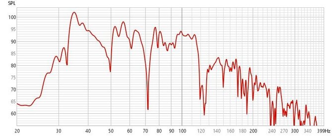

This is my subwoofer response after audyssey calibration. I am using a Denon X6500H with Definitive Technology BP 2002TL powered tower speakers. I am using the two 12 inch powered drivers on these towers as one subwoofer and a JBL MP418S as my second subwoofer. My question is how can I improve bass response. What should I do to make it more linear or flatter. Also what smoothing option should I use when examining bass response? In this graph I used no smoothing.
