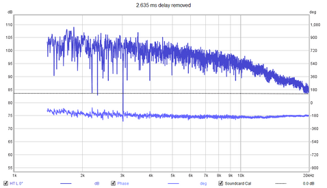

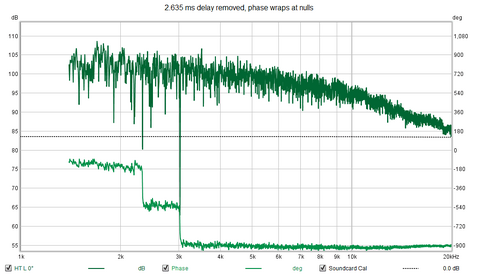

Hi John,
for measuring my speakers with time alignment i ordered a ECM8000 and i am using it on my Steinberg UR22MKII.
I made the following setup:
1. no loopbak in Steinberg`s ASIO driver with 48kHz, i switched phantom voltag ON
2. i plugged MIC into INPUT 1 and my amp in OUT 1
3. i made a loopback from OUT 2 to IN 2 (via cabling)
4. i think after leveling the input and outputs everything should have enough signal (no warnings for clipping or too silent signals)
5. I made a calibration and the diagram fits, i guess
6. i measured my speakers and i got an awful phase measurement
So i think, i am having a problem in my setup. Do you have any idea whats wrong ? I am using your newest Beta...
