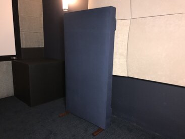

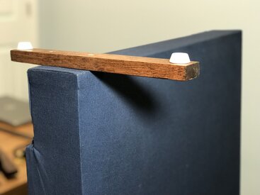

Now in preparing for Skip's room, I've been working on some acoustic treatments for his room. Because this is an Expo it is preferred to be able to have the treatments be free-standing. This is not so common for a DIY effort and I needed t come up with something that is show worthy. I made legs for my panels using 1x2 mahogany with a black walnut tung oil finish, and a DIY beeswax topcoat. I'd love to tell you some grand story about how I can only get that perfect shine with my own special recipe of waxes, or that the waxes somehow improve the sound. In fact, I am cheap and didn't feel like buying a tub of wax for this. I had the ingredients to make my own and so I did. This one contains a mix of real bees wax, olive oil, and orange oil.
Having the panels free-standing will be nice because I can tweak the response in the room by moving the panels farther or closer to the walls, angling them, etc. The panels consist of 4" thick 8lb density fiberglass in the bottom half of the panel with a film membrane over it. On top of that is another 4" section but with bluejeans insulation, no membrane. The entire back of the panel has a polymer membrane and burlap cover. The panels are covered with a navy blue acoustically transparent fabric.
Close up of the feet being attached. They are attached with 4" long Brass screws.
And testing them out! Check out those feet baby.
