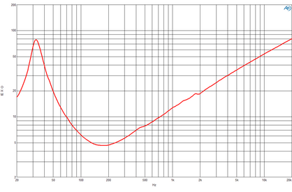

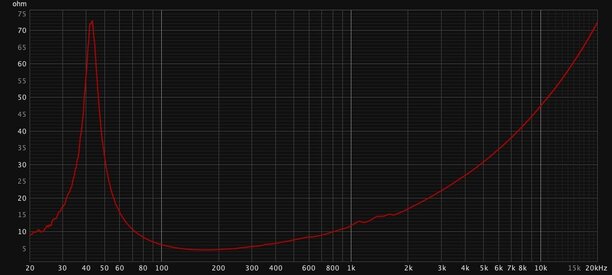

1) B&C 15NW100-4
vs
On my measurement, the first peak (resonance frequency) is 42.5hz@72ohm, but it should be ~33hz@80ohm, yes?
Why this difference?

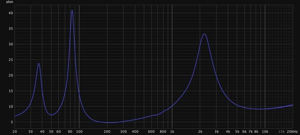

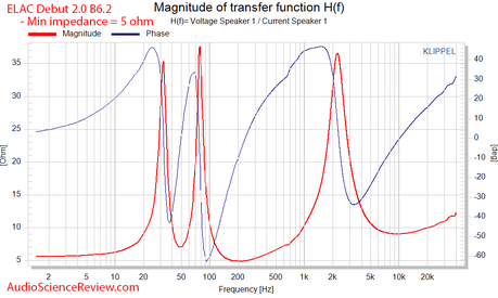

2) Elac Debut 2.0 B6.2
vs
Why is the impedance at peaks so different? Especially for the first peak?
I attached the .mdat.file
Please explain to me what is wrong and how can I fix it.
