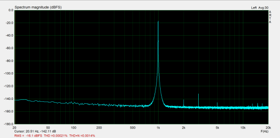

I initially thought is was the new M4 firmware, so fired up ARTA to see if it behaved the same - I think it should if the new M4 firmware or software is at fault.
It did not - see image 2-ARTA, so I suspect REW. BTW, the ARTA image is close to what I normally see when REW is running correctly.

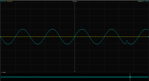

I ran the REW o'scope to see if I noticed anything about the generator output and saw the distortion shown - see image 5-scope_generator_on REW.

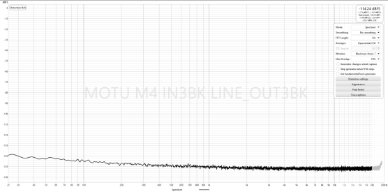

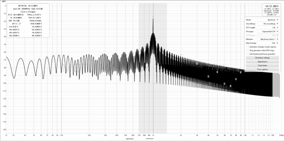

I included a couple of shots of MOTU M4 output: 3-loopback_generator-off REW shows output when generator is off; 4-loopback_generator_on-12dBFS REW shows output when generator is activated to put out -12dBFS sine at 997Hz.

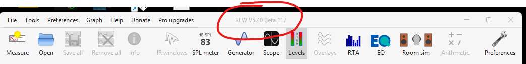

1-REW version

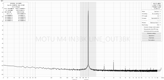

Nothing to do with the REW version, samples were being missed. Check the buffer size if you are using ASIO, the firmware update may have reset it to a lower value.
