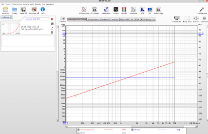

I wonder why the phase is limited to +-90° in impedance measurement? That means the result is not a complete system description, right?
If the phase of a passive component's impedance was beyond 90 degrees it would mean it had negative resistance.
That particular measurement also suffers from the input swap problem, since it is an inductor but the phase of its impedance is negative instead of positive.
Thanks for the reply. Now that you remind me, i withdraw my embarrassing question about fundamentals....

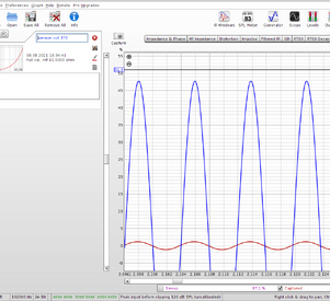

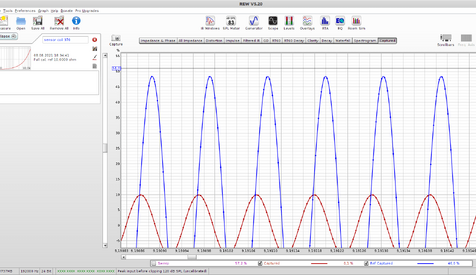

A more interesting point is, that if you look at the captured data, the phase between Captured and Ref Captured runs from 0° towards 90° with increasing frequency. The diagram shows a constant phase, which to me seems not related to the Captured data.

At very low frequencies the phase is close to zero as the impedance is mainly resistive. Phase is not constant for valid measurements.
44070
Right, your example looks reasonable. What i get is totally flat, and that is not what i see when i look to the captured data:
That's probably a calibration problem, the phase also has the wrong sign. Perhaps a channel swap during calibration?
That channel swap problem is extremely annoying, and i cannot figure out where it comes from. As i utilize a Laptop with Linux, i am more or less limited to USB sound cards. Mine here is Asus Xonar U7, which has excellent low THD and noise. I also tried that card unter Windows 10, but Windows sound system is a serious nightmare: it is noisy, seems limited to 16 bit, and i could not get any sampling rate beyond 48kHz, no matter what i chose. So i will probably pick another one to test, unless you have another hint?
You should be able to get the same performance on Windows using ASIO drivers as you get on Linux, using FlexASIO if the interface has no native ASIO drivers.
I tested a Asus Xonar U7 MKII instead, and it shows the same channel-swap failure. I tested a Steinberg UR22mkII and it does not show such a failure. Both tests on same Linux PC. I also tested recodings with plain alsa tools: the U7 worked perfect with this, it never shows such a channel swap. At the end it looks like root cause is a incompatible combination of the U7 sound cards with the Java Audio Interfacing. Solution for me and recommendation for all users is: don't use Asus Xonar U7.
