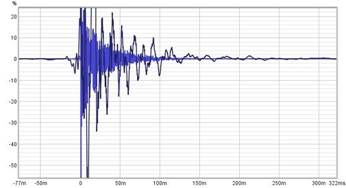

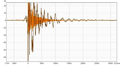

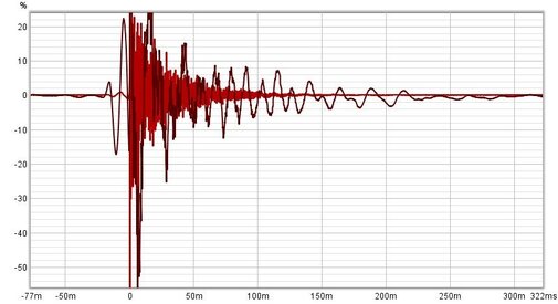

W Wull Registered Thread Starter Joined Apr 26, 2018 Posts 52 Apr 25, 2020 #3 results below. Attachments PHASE CHECK.mdat PHASE CHECK.mdat 4.6 MB · Views: 83 right in phase.jpg 47.3 KB · Views: 85 left in phse.jpg 51.5 KB · Views: 84 center in phase.jpg 50 KB · Views: 70 center out of phase.jpg 50.3 KB · Views: 73 Last edited: Apr 25, 2020

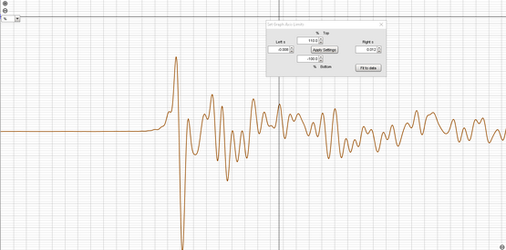

W Wull Registered Thread Starter Joined Apr 26, 2018 Posts 52 Nov 22, 2020 #6 John Mulcahy said: All in phase. View attachment 31162 Click to expand... Hi John. How do I set impulse to this scale (2.00ms)? Last edited: Nov 22, 2020
W Wull Registered Thread Starter Joined Apr 26, 2018 Posts 52 Nov 22, 2020 #8 Thanks John. I did know that, just wasn't sure how to set it to 320u/2.0ms. Think I'm OK with the settings I have. Attachments REW inpulse.PNG 25 KB · Views: 59
