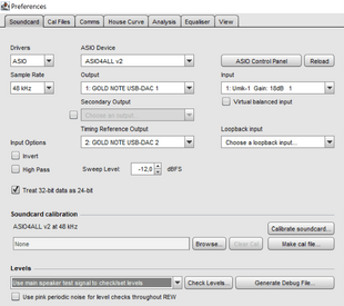

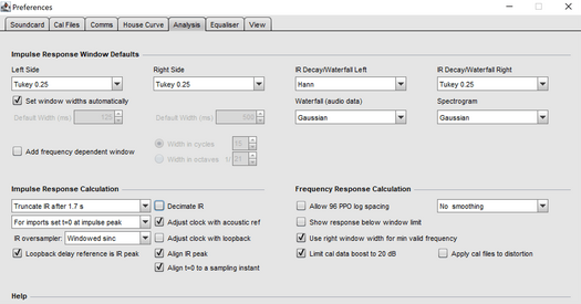

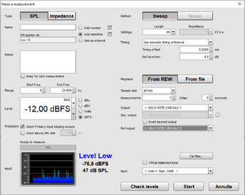

Hi all, below my settings.
1 and 2 pics the only parameters I changed after deleted all the settings
3 pic my measurements details.
John, if I use secondary output both channel works. Right channel alone works but left channel alone doesn t work when I try check levels

7,411
That sounds like the muting problem I mentioned. You could try switching the timing reference to use the left channel, otherwise as a crude workaround you could use L+R and unplug the output you are not measuring, but that will be awkward for the timing reference. If you are able to contact Gold Note it would be worth finding out what they suggest. I can look at adding low level noise to the signals to stop DACs from muting, but that would need some investigation to make sure it can be added where it won't degrade the results.

I got some result in this way: I did measurement for R ch. and then I switched R with L line output from the dac in order to let REW think that I was using always R ch. The issue is that I did it with "no reference timing".
Now the convolution filter with inversion that I created seems to work quite good but for 44.1MQA. It works for 44.1 standard and 96 MQA, but with 44.1 MQA the sound is accelerated (about 10%). is that related to "no timing reference" mode or it´s something else?
thanks again for your support.
if it´s an issue of MUTING why only L channel doesn´t work and R channel yes, and why in check levels also? Futhermore, when I use timing reference on R channel it seems REW or MIC doesn´t recognize the reference sound
7,411
Do you hear the timing signal when it is on the R channel? As above, some DACs mute based on the content of only one of the input channels, for your DAC that may be the R channel. When you try and measure the left there is no signal on the R, so the DAC decides to mute both outputs.

Regarding the DAC problem, I have added a "Fill silence with dither" option on the Measure dialog in the latest V5.20.14 early access build. Worth trying that.
