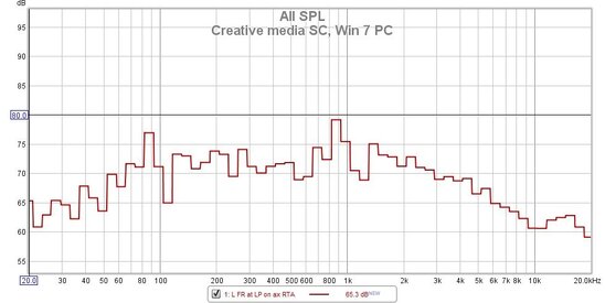

Now the win 7 pro PC with sound blaster creative media Audigy sound card with all enhancements/EQ turned off. In this case my bass reads a bit better still not correct but the high frequencies are not there, over 10db below main signal level. These are raal ribbon tweeters, flat to 20+K. Same RTA PN signal, mic at listening position and on axis with speaker as above measurement.
32081

A soundcard can be measured by connecting its output to its input, but it would be unusual for a soundcard to have a response that isn't flat bar the very highest and lowest frequencies. More likely is some processing affecting the output. For example, various effects may be active by default (though turning off the enhancements in the sound properties should disable those) or the speaker output may be configured in the OS as being laptop speakers and so receive a bass limited signal.
John I checked all the above and the speaker output was listed as large external, but what about the high frequencies even with laptop speaker setting that should not have been rolled off. I can easily check the Win 7 PC sound card (freq resp) but checking a laptop is a bit more complicated as there is only a headphone/mic in/out jack, how to connect those two together? I reached out to MiniDSP and opened a ticket to get their take on the situation as well. I purchased the Mic directly from them. It would be nice if I could use the UMIK with my clio system but it does not seem to recognize the UMIK.
From what I see on the answer with the Creative sound card the microphone calibration file is missing, and the sound card should also be calibrated in loop mode, although in this case as a USB microphone is used this additional calibration still introduces an error due to the ADC converter response that would not be used for USB microphone response. For this reason I always use pre-amplified analog microphones that also use the ADC converter as well as the DAC for audio output.
Antonio Thank you for the reply, I replaced the creative media jpeg with the microphone calibration file included, the original shot was just all SPL which does not show calibration files. I will have to study the loopback method of sound card calibration for a laptop with only one headphone/mic jack, but will still have the issue you pointed out. May I ask what mic and setup you use? It seems a lot of people use REW with the UMIK or EMM mic and get satisfactory results and I no information with REW guides on sound card recommendations.

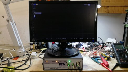

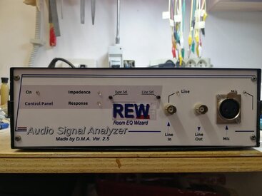

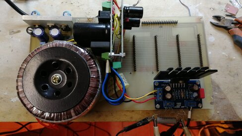

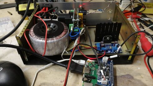

I design all my circuits and the preamp was also made by me, so I can't help unless you are an expert in electronics and you can build a circuit yourself. To be clear, I send photos of my latest creation built entirely in my laboratory.
