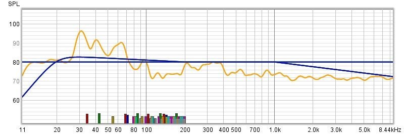

I'm new to rew and proberly having some newby problems.
The System;-
Dutch & Dutch 8c
Four SVS SB16 Ultras
Room size 6m by 5m
I have tried to level match the four subs to 90dbs @ two feet from each sub
The rear subs are at 160 degree phase the front subs are at 0 degree phase
Using the 8c tab within REW I get two problems when taking a measurment.
1st is I get typicaly a notice that says the response is 91% above target
2nd is I get an error message informing me that there is no Automatic filters to configure
Would some please advise this dumkopf on what I'm doing wrong, how to do it right and best practise for measuring the system.
I have attached a single sweep with 1/6 smothing from all the speakers in the system.
Thank you
