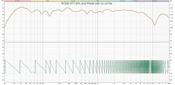

Yes, I did. No calibration file available for the NT1.

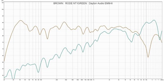

Here is a graph showing SPL from the two mics that I took today . . . mics are both set up on different stands, right next to each other, at the listening position, and plugged into different inputs on my interface. I initially set both mics to -18 dBFS using "Main speaker test signal", but had to turn the gain down on the EMM-6 during testing because it overloaded in the upper frequencies. It's closer to -21 dBFS now.

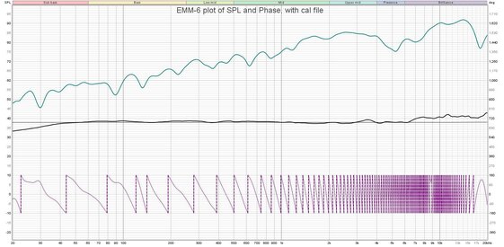

Here are two plots showing SPL and Phase, along with the mic cal file. Note all these files have 1/6 Smoothing
I just can't believe that there's not something wrong with the EMM-6 mic . . . looks terrible.

Pretty odd response from the EMM-6. Looks as if it may not be getting phantom power, but you said phantom was enabled for it.
Yes, absolutely. I just switched the power off on the EMM-6 and it went silent. Power back on; noise back up. I also switched the cables between the mics, problem stayed with the EMM-6.

OK, so I returned the EMM-6 and purchased another one . . . . and the new one looks nearly the same as the old one. Same shape curve, within the limits of positioning. As a check, I took data one more time with a Shure SM57 that I had available, and it looks much closer to the RODE results than to the EMM-6. I also routed the EMM-6 through my mixer instead of direct into the interface, to check for issues with the mic preamp or phantom power . . . results were identical.
Two mics couldn't both be bad, and I can't believe that the difference in the two types of mic would make this huge of a difference in the response. What the heck am I doing wrong?
