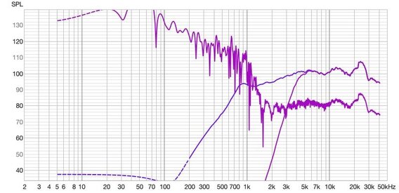

Thanks John for your work on this program is truly appreciated .
I'm having some issues when using the "Measure with these filters" The sweeps sound like they have the correct filters applied but when displayed they look as if they had some completely different filter.
I'm using a Mac mini M2 osX 14.1, REW v5.30.9, Behringer UMC1820 interface running at 88.2khz sample rate, checked in Midi Audio setup & Earthworks M23r mic Using the generic EQ and just LR filters. The 'make measurement from predicted' looks exactly as expected.
I'm sure this has worked before so perhaps I've inadvertently changed something along the way.
Many thanks for any help
