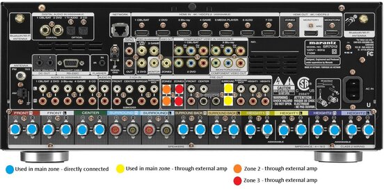

To start with, I sketched what I think I need.(file SR7012 - 11.1 Zone 2 Zone 3 Setup.jpg) I have assigned 9 outputs (as you pointed out) to the main zone and assigned the surround speakers to an external amplifiers and did the same for the pair of speakers in zone 2 and the other pair in zone 3.

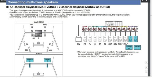

Now, after reading the doc, I took a second look at the 7.1 channel playback setup (pictured in file SR7012 7.1 setup.jpg) and started wondering. Wouldn't that work? I mean, couldn't I simply connect all my main zone speakers in that way and simply assign my zone 2 and zone 3 speakers to an external amplifier?
I guess my confusion was your original post which said that wanted a 11.1 plus the additional zones. Typically the 11 means 11 speakers used at the same time in the same listening environment and the 1 means 1 sub. If you are actually going to have a 7.1 then you will only be using 7 amplifiers (subs typically use the LFE out which does not use an amplifier) for your home theater leaving 2 open amplifiers and 2 open outputs for amplifiers. In that case you should be able to add 4 speakers for your zones with 2 connected to Marantz amplifiers and 2 connected to the external amplifier. Hope this helps.

I am going to have to look at the Marantz documentation to give a more informed answer to your question. My guess right now is I do not think you can do what you want to do as you have used up all the channels with the home theater (9 amplifiers and 2 RCA to external amplifiers). You want to drive two more zones but there are no outputs left to do that. This receiver was designed to drive, for example, a 7.1 or 7.2 then the other 4 remaining outputs could drive external speakers (assuming you use 2 RCA for an external amplifier for the 7.1). Count your speakers; you can drive 9 directly from the Marantz and 2 more from an external amplifier. I believe that is the limit. In my case I just picked up a used Onkyo home theater AV receiver on Craigslist for around $150 and I power my other zones with that independently.

The fundamental problem you have is with the 11.1 selection (7.1.4 for Atmos). Choosing that will leave no other output for your external speakers. When you go through the Audyssey setup on the Marantz you will be assigning all the outputs to the surround speakers (fronts, center, rears, side and ceiling/height). There is no way that I know of to do the external speakers other than one of three ways.
The first is to do a selector switch but unfortunately it has to be on the front speakers as all the other do not have true stereo as they are doing surround functions. This means you will have to put the switch on the external amplifier to get stereo in the other rooms. This means you will not be able to listen in the main theater room fronts and the other zone simultaneously. Also only one zone at a time. I don't think this a path you want to go down.
A better path would be to buy a Heos enabled speaker (Best Buy/Amazon/Ebay/etc.) for your external zones and stream from the Marantz using their Heos system. I have never done this so you might want to speak to Marantz tech support to make sure this will do what you want.
I don't know what else to tell you if your heart is set on having the 4 Dolby Atmos speakers. If you want the full immersive effect of the home theater experience you probably would want to also add a second sub. My system is 7.2.4 which means 7 speakers at listening level (fronts, center, side, rear), 2 subs and 4 ceiling speakers for Atmos. If you do not want to go the Heos route then maybe dial back to a 7.1 or 7.2 and use the remaining outputs for your other 2 zones.
Regarding an external amp for your front speakers take a look at the Outlaw 2200 monoblocks. They are are rated 200 watts 8 ohm and 300 watts 4 ohms so you would have plenty of headroom for your Sony speakers. They are very reasonable in price at $399 each.
