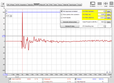

No, but measurements can be manually shifted using the controls on the Impulse graph.

7,315
The adjustment is individual for each measurement. If all have the same timing offset the adjustment will need to be applied to each. REW doesn't have a global timing adjustment to apply to new measurements, though it is on the todo list to consider.

Hi!
I had the same problem - a large distance from the test pulse to the measured one so the unfolded phase was not visible. I used the automatic mode - the button " Estimate IR Delay ". Time can be adjusted manually in the window " t = 0 offset (ms) "
