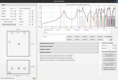

REW has a room simulator.
Hi John,
Amazing!
Thanks for the comment!
I'm from an era when you wanted a program, you'd have to write one, and that's precisely what you've been doing. Respect!

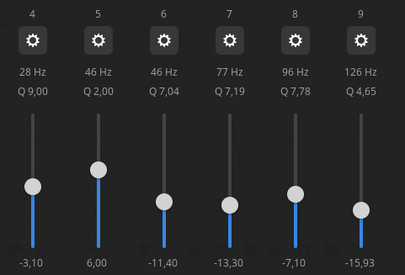

At first, I didn't hear the narrow peak at 45 Hz affecting F1 and F#1, but after a very slow sweep or pink noise, it's right there and perfectly audible. Added a narrow filter to take care of that.
That is getting interesting. I'm learning how REW works and that represents a lot of reading. I'm at the measurements help page now.

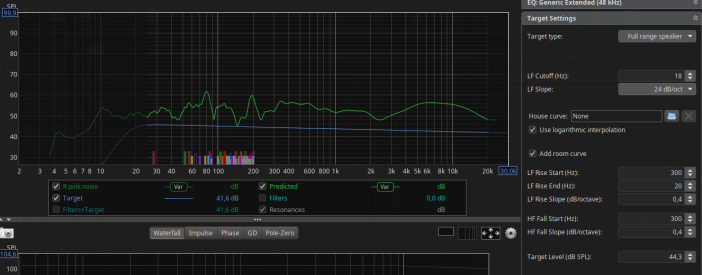

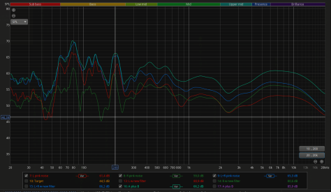

For experimenting, I placed an usb webcam (for its mic) in a random place in the room and sampled 5 sweeps. Discarded 2 that were too way different and averaged. I know the mic goes at the LP, but I'm just trying to understand the basics from the very beginning.
I generated filters for 20-200 Hz from the EQ panel, applied the Harman curve and imported the 6 resulting filters created by REW into Easy Effects.
To my surprise, there was a significant improvement from manual processing (45 and 80 Hz filter pair). The bass response is way more natural.
Didn't process any phase / delay. Don't know yet how to do it precisely.
