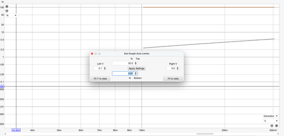

another report,
when in distortion panel
is not possible to enter manually any value in the set graph axis limits, the values can be changed only by the arrows.
This happen on REW 5.31.3 and 5.40 beta 61.
That is the case when the axis only permits certain values.
