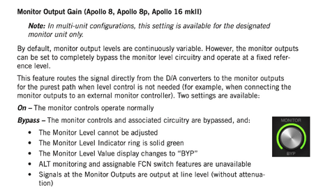

Shall I bypass this option (pls see screenshot here attached) to obtain the process for a valid REW measurement ?

Thx a lot now it works properly, no more feedback/larsen :)
